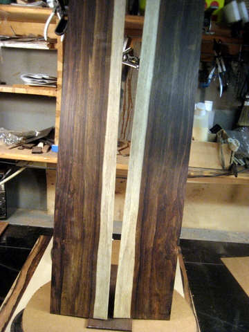

I know how much you all like pics so here we go.

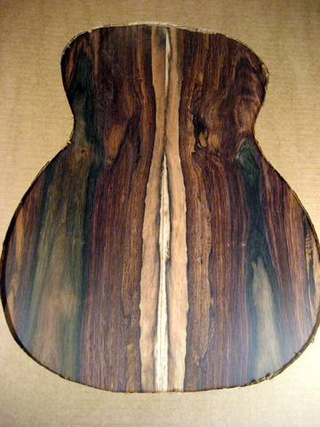

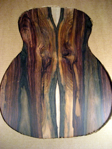

First, looking for some feedback on which orientation you like best for back.

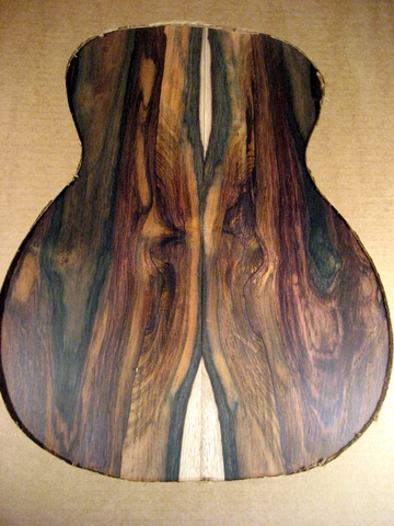

#1
#2
#3
#4

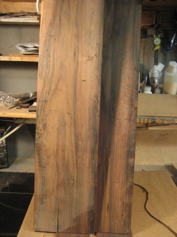

Thinking of removing the heartwood

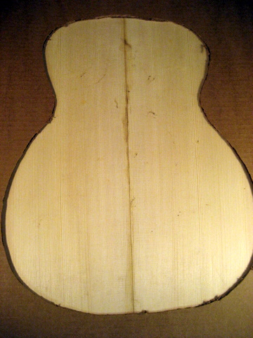

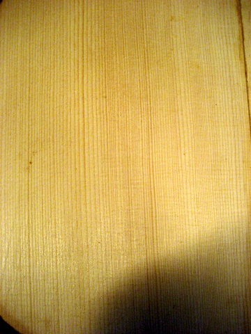

A shot of the soundboard
Closeup

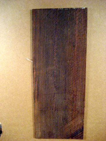

Headplate

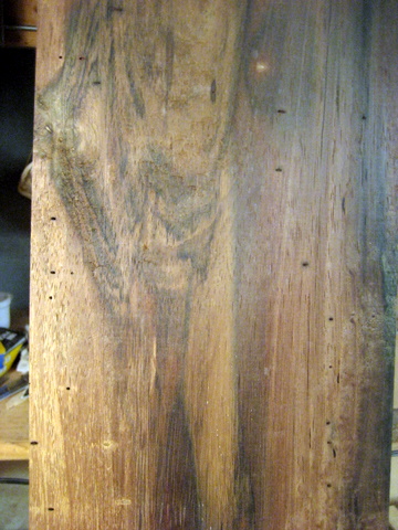

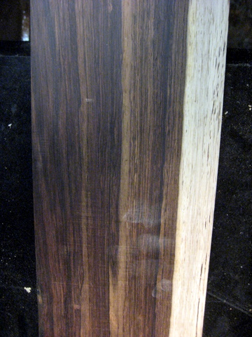

Sides
Now wondering if the heartwood from the sides might make for nice binding. Anyone ever use heartwood for binding. Maybe with BWB purfling on bottom and top?
Or I could cut up these sides for bindings. This is what I was thinking for laminated fingerboard and bridge but think I will use solid and get something dark to match up to the headplate. Bob C already responded to an email and I know he can fix me up in this area so deciding not to use laminates
Would you use the heartwood and end up with white bindings or go with the lighter orangish brazilian for bindings?
PostPosted: Sat Oct 28, 2006 7:47 am
Forgot one options for b/s. I could cut the heartwood our of #1 and match up the almost black center if you can visualize that option.
PostPosted: Sat Oct 28, 2006 7:48 am
[QUOTE=rich altieri] Forgot one options for b/s. I could cut the heartwood our of #1 and match up the almost black center if you can visualize that option.[/QUOTE]
Or #2, cut out the heartwood?
PostPosted: Sat Oct 28, 2006 7:58 am
Number 2 looks more balanced. I like the symmetry of the larger "heartwood" on the lower bout and the slimmer heartwood stripe on the lower bout.
*passes out* CAUSE: Sensory overload....

I think I like #4
PostPosted: Sat Oct 28, 2006 9:24 am
NUMBER 4 ALL THE WAY!!!!

3 or 4
PostPosted: Sat Oct 28, 2006 10:32 am
I like 3, but I think I really like 4 the best. So yeah, 3 or 4.

i would use no 1 if it were mine... wistful sighs... avaricious stares...
PostPosted: Sat Oct 28, 2006 10:55 am
Interesting....I like #1 or #2....
PostPosted: Sat Oct 28, 2006 11:11 am
I like #2 best, followed by #4. NICE ZOOT!!

Hi Rich, I like that sap wood (the white bits) so for me I would go with #3 and use the wormy sides for binding. I think that would look cool!

rich,
based on the responses so far it seems you can't really go wrong - beautiful wood will make a beautiful guitar - no matter how you slice it, it seems.
my preference is #2 though. that sap wood at the top of the lower bout being topped by a dark braz heel cap would look stunning.

It looks like a tight vote! I agree w/phil. His comment about a contrasting
heel cap was the closer for me.
Chalk me up for #2...

3 or 4

I like number 4 but I'm not sure about how the heartwood binding would look. I suppose with the black purfling it would at first glance appear like a typical BWB plastic binding so I think that would be pretty cool.

Number 4. It just seems better. That is going to be a seriously nice looking guitar.

#4 for me, no to the heartwood bindings

2

Rich, I am with Sam -- I like #2 best. It has the best symetry. I see a pair of eyes in #2 at the waist. Kinda reminds me of Mother Willow in Pochahontas (Disney animated movie).
That'll make a gorgeous guitar....I look forward to seeing the progress pictures!!
PostPosted: Sun Oct 29, 2006 6:18 am

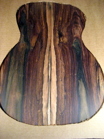

Thanks guys and gals. Looks like we are all over the board on this one. I went with #1 but I narrowed the heartwood a bit. Glued her up last night. Will post some pics maybe later today. Also glued up the top and started the rosette. Going with a .25 ring of Brazilian with BWB on each side and then on the inside and outside rings I am using some Pink Heart pearl with BWB. Got the Brazilian inlaid just now and will do the BWB banding later today. Will post pics.

#2 would have been my pick. I like sapwood.

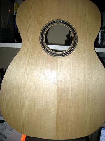

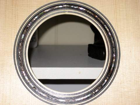

Finsihed rosette tonight and applied couple coats of shellac to protect. Ended up with a change on the rosette from my original plans. First I inlaid a brazilian ring wtih BWB purflings. Once thr ring was glued in, I routed the outer and inner purfling channels - a trick I picked up here some time ago. Makes a really clean job.
Next - routed the center and installed the Pink Heart. Then decided to do a BWB on outside and inside.
Looks much better live - can never get the lighting right for the camera but thought I would throw this up.
Brought the top down to .10 which is thinner than I normally work with but the top was pretty stiff both ways. Hope it holds up.
